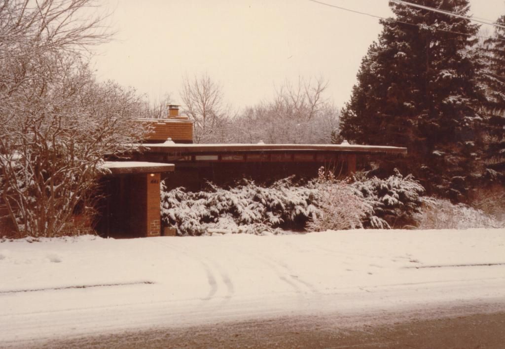

I think contractors have become more educated over time. The photo below shows the Jacobs House in Jan, 1983. The new owner of the house called a roofing contractor about the condition of the roof. They found 16 layers of built-up roofing - so many layers, that large pyramidal roof vents were added to remove the air pockets between the layers of asphalt laden felt during the summer months. His recommendation for a long-term solution? Add framing as needed to install a sloped, hipped roof and install asphalt shingles. "That's the only way to fix a flat roof".
