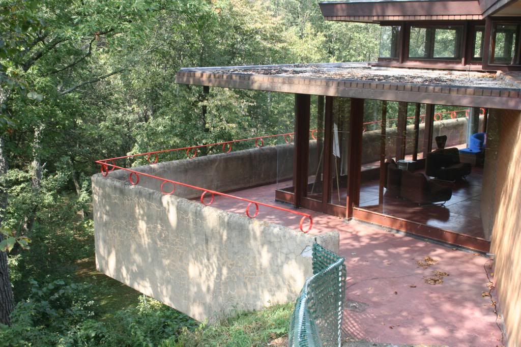

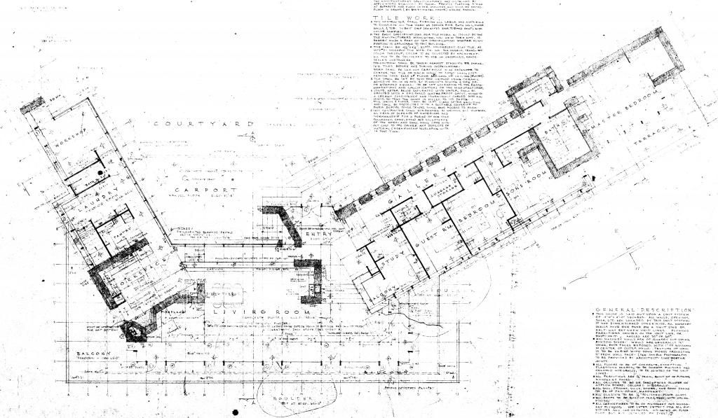

The owners of the Greenberg House have decided to complete the home as designed by Wright in 1954. Maurice Greenberg was unable to complete the house, but had the foresight to order enough brick to finish. The living room roof extends over the space with no visible means of support at the balcony wall. The lower roof is actually hung from steel beams founded in the high ceiling - I've never seen anything quite like it.

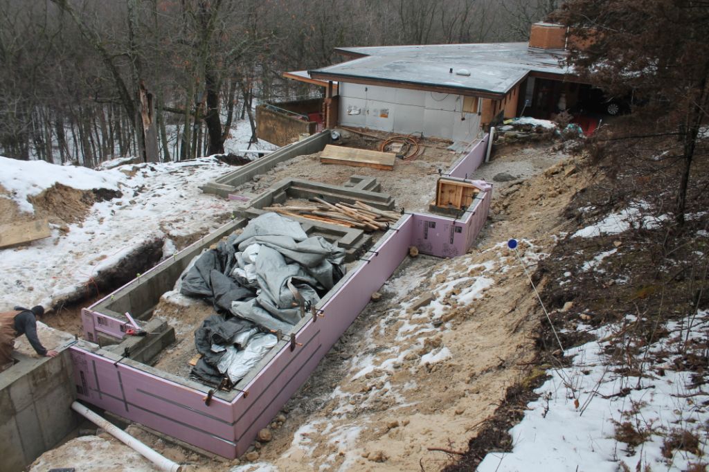

Luckily we had a warm fall and early winter, allowing the foundations to be poured. Floor slab and framing will begin in late March, weather permitting!

Wow. An impressive project (and a delightful plan). It will be fun to watch this one.
The first photo certainly does present a head-scratcher. If the lower roof is hung from the upper one, what (one wonders) supports the upper one ? And (incidentally) what is the bit of "flue pipe" visible just outside the upper glass ?

the upper roof contains steel beams that rest on the masonry elements shown on the plan - they cantilever out to the clerestories, and then steel rods extend between the sash to support a header below. The living room and balcony themselves are cantilevered as well. Very precarious.
the large pipe you see in the photo was a temporary method of removing water from the upper roof. Its now been removed.

Wow. Thanks. The slight-of-hand routinely performed at Taliesin does boggle the mind, doesn't it. The resulting effect -- slender verticals and hefty, generous horizontals -- is worth it, every time, it seems. One is not invited to explore (or even notice) the machinations necessary for the effect. "Don't look behind the curtain -- nothing to see here !" The Wizard of Spring Green . . .
Gotta love that parapet-raising metalwork. Wonder when that appeared. The rings seem to have a life of their own, spinning willy-nilly ? One does find, again and again, surprisingly low parapets at Wright's decks and terraces. How do the ones at Fallingwater feel, to the visitor ?

The plan of that house reminds me a lot of Goetsch-Winkler II.

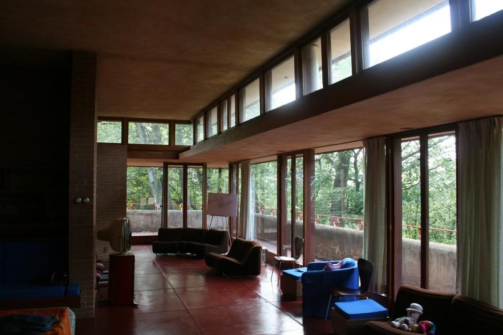

A better view of the expanse of glass in the living room, with an enlargement of the framing drawing illustrating the steel in the upper roof. I particularly like the "teeter totter" steel at the chimney, to the left.

Please keep us updated with photos as time and weather allow; I'd be very interested in seeing the process of placing and finishing the red tinted slab.

What is going on with the circular detail on the metal railing? In this photo it looks like it gradually shifts from perpendicular to parallel. Is there some sort of pattern there?
Posted: Thu Jan 24, 2013 1:08 pm
by outside in
the rings and rail are a temporary solution to the low balcony wall - code says 36 inches high, built at 30. Low on the priority list right now.........
