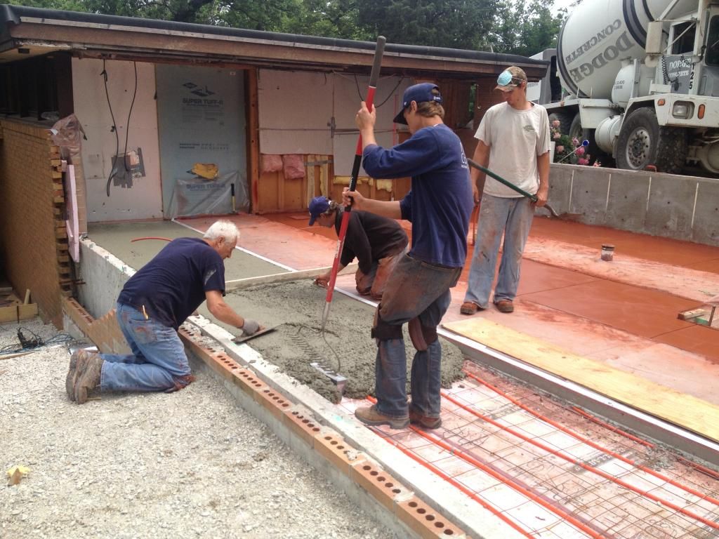

the framing of the roof over the living room is complicated. I think Wes Peters was behind this, but basically there are two steel beams that cantilever out over the room from the masonry piers on each end. The lower roof, beneath the clerestories, is hung from the upper roof on one side and supported by the glass wall on the other, giving the appearance of a floating wall.
The interior and exterior slabs are poured with a thermal break between consisting of 2 inch thick piece of rigid board, as a great deal of heat can be lost at the edge of the slab.

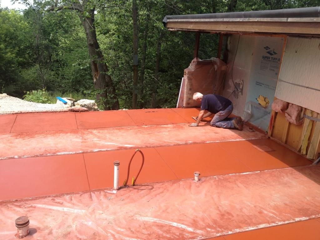

What product/system did you use for the red tinting of the concrete slab? Is the same system to be used for both indoor and outdoor applications?
Thanks for sharing pics BTW, this is a joy to see.

L.M. Scofield with a tinted sealer.
Owner has also purchased two gallons of Kemiko Wax from the director of the Kraus House in St. Louis for ongoing maintenance - highly recommended for concrete floors as it puts down a "sacrificial layer" to take daily wear and tear, protecting the tinted concrete below.
also - brick work matches existing/original - no flush vertical joints

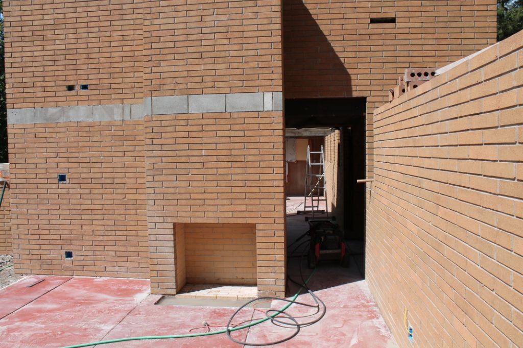

The fireplace seems remarkably straightforward. Is there another element on its way which might create a more complex or asymmetrical composition?
The whole thing looks great!

I was a little surprised too, but Nope, that's it, straight off the working drawings
