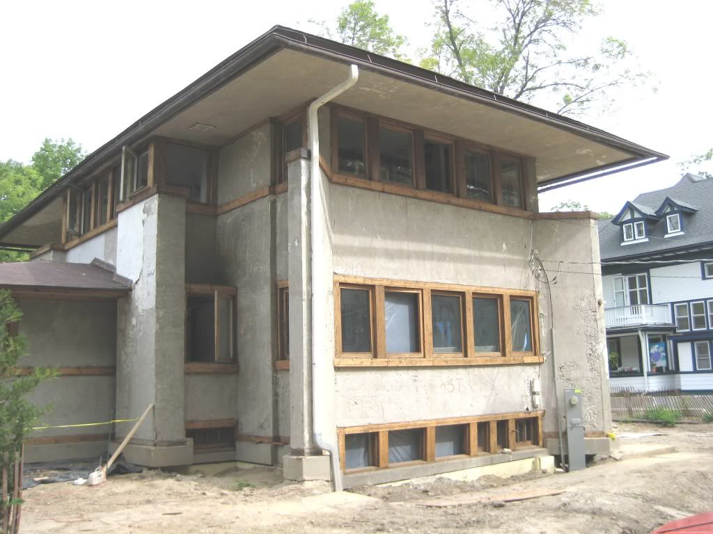

The East Elevation was in particularly poor condition.

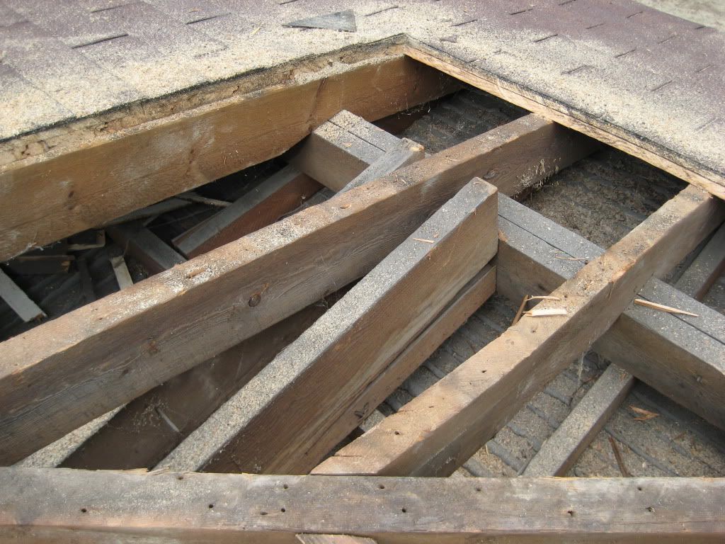

Mary Adams Update - The exterior stucco has been cleaned of paint and various plaster/acrylic finishes. Finish coat will be applied after wood staining, roofing and other exterior work completed. Currently repairing sagging cantilevered roofs by adding steel to the hip rafters. Sheathing is removed and roof framing exposed:
Exposed framing shows 2-1/2 inches of "meat" over exterior wall framing (no wonder it deflected). Flitches to be added to one side of hip rafter and through-bolted.

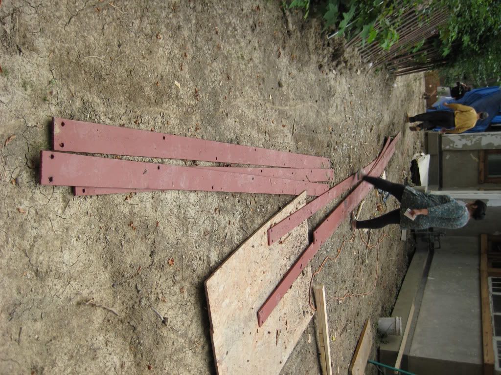

Steel plates ready to be installed.
Porch roof is not level, east side is about 3 inches lower than west side:
Support header at ends of cantilevered beams are both split - header attached (nailed) to bottom of header - deflection occurred when beam ends split. Roof to be jacked level, beam ends wrapped and sister beams to be installed.

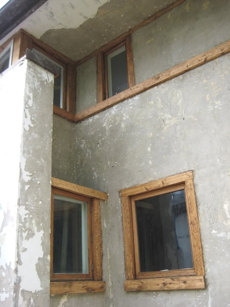

Exterior Pine trim is now stripped - new stain to be applied after final wood cleaning. Windows are currently being stripped - paint analysis shows that the current ivory color was painted over the original brown sash color.

The windows and trim wood look great after stripping. What method was used to strip them?
Was any wood in need of outright replacement?
Posts: 1338
We haven't fully assessed the condition of all of the trim, but it appears that it will all be salvageable. The overhangs do a pretty good job of protecting the sash and trim, but on the west elevation the windows are pushed out to within a foot of the fascia, and the trim at the sills is marginal. We are going to experiment with the West epoxy system to rebuild the wood profiles and stain over with Sikkens - probably a semi-transparent stain.

One of those steel plates is notched, and maybe at both ends. It's really long too. At the risk of being a greedy pest, would love to see some posts of that installation. Many thanks for this though.
Posts: 1338
Tom,
Hmm, didn't notice any notches this morning - maybe you're seeing sticks, grass or something? I'll be happy to post pics once installed.

outside in wrote: Image
Looking good! In the band of basement windows there is an extra mullion on the right side that appears to have been added. Is that original or was it added at some point in time? What is its purpose? Will it remain?
Will the current transformer cabinet and overhead electric service remain?
