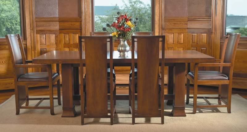

Is one of your goals to try and furnish the house with FLW furniture as close to Davenport's date (1901) possible? With Roberts and Boynton dating from 1908, could these Dana-Thomas (1902) designs - Dining Room Table ..... Large Side Chair ..... Low Side Chair - possibly fit the bill?
In addition to considering the date of the house, the style should also play a part. Davenport is simple in the extreme, and calls for furniture of the same mode. The set you show looks about as basic as possible, and would fit well into your house. Don't get too fancy.

I agree with Mr. Grant. IMO, the high backed spindle chairs do not at all work with Davenport. Even not knowing what the room looks like (hint hint) the choice shown is excellent, and although there is little curvature in the elements of Davenport as far as I can tell, Wright often made geometric detailing combinations throughout his houses.

Given that the Davenport House has a square spindle motif that repeats throughout the interior and screens the main entrance, I will do dining room and living room furniture with square spindles. I will probably do straight back chairs in the dining room similar in design and scale of the mid back dining room chairs in the 1902 Dana Thomas House in Springfield, Illinois. These chairs will also be similar to the dining room side chairs of the 1908 Isabel Roberts House. It is comparable in size to the Davenport House. I do not care for the compromised dining room chairs with angled spindles. I will probably make the seat bigger by 1 inch in each direction and add a removable lumbar support cushion for comfort.

As much as I like the high back side chairs, the scale of these side chairs strikes me as being more appropriate to the size of the dining room in the Davenport House.
I certainly enjoy sharing what's on my shelves.
I think there is something to be said for having the freedom of movement that a chair back below head height provides. The chairs in that Dana photo seem so handsome. . .
