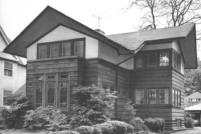

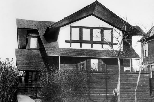

1901
1931 Alterations

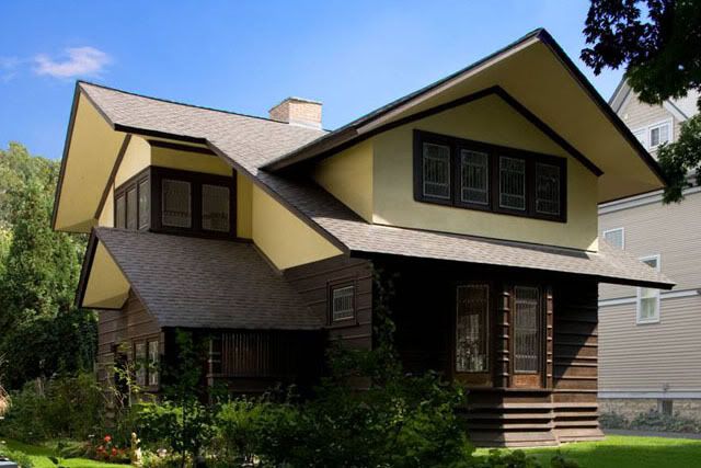

2007 Restoration

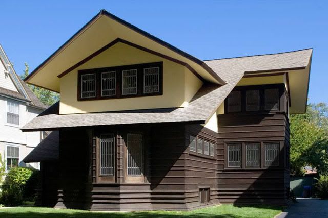

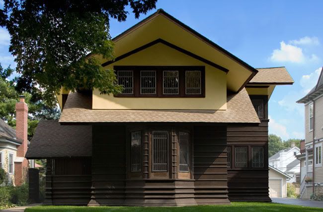

West Facade
View from Northwest

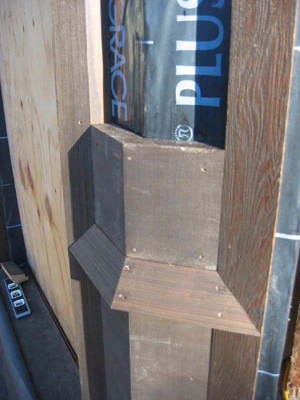

Detail at Bay

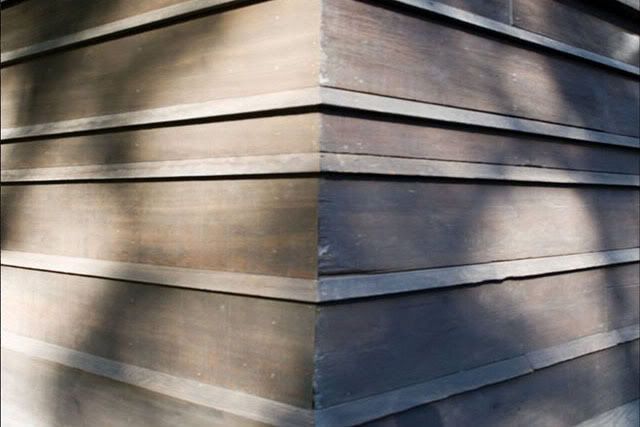

Siding on Left is Newly Installed Recovered Cypress which is Same Age as Original Cypress Siding on Right

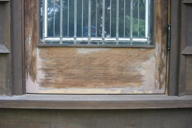

Door Prior to Restoration
Restored Door with Cypress Dutchmen and Epoxey Filler Prior to Staining

I must say I like your west facade better than the earlier two -- including the second-storey window. The trim running around the base is so fine. . .
It must have been a trick to restore the roof to its original configuration. Congratulations on an elaborate restoration and a labor of love.

The trim at the base of the second story window will be added when we do the balance of the lime plaster work and install the cedar roof.

How are you and your local government doing relative to recreating the original enclosed verandah? Do you have thoughts as to why Wright originally built such a high wall? Of course it offers privacy, which is important, but wouldn't the height also prevent breezes from entering the house or cooling the occupants of the verandah? I've always been a little puzzled by these enclosures.

Oak Park Jogger wrote:Do you have thoughts as to why Wright originally built such a high wall? Of course it offers privacy, which is important, but wouldn't the height also prevent breezes from entering the house or cooling the occupants of the verandah? I've always been a little puzzled by these enclosures.
The wall is approximately 32" above the top of the wood deck. The top of deck is approximately 2" beneath the the finished floor elevation of the living room. This partial height solid wall around the veranda is relatively common in Prairie houses of the period. I have been on many of these elevated verandas and they are actually rather wonderful for the occupants. They are not tall enough so as to block daylight or cooling breezes from entering the house, yet they provide visual privacy to users of the deck from people walking by on the sidewalk. Other owners with whom I have discussed these elevated verandas are quite happy with them.
This solid wall around an elevated deck carried over FLW's residential projects for the next 58 years of his long illustrious career. Apparently he was quite fond of this idea and received positive feedback from his clients.

One question. I notice a difference in the trim at the second story windows as shown in the 1901 photo vs. the as restored photo.
Would you give us the story behind this restoration choice.
Thank you for the compliments. The trim at the base of the second story window will be added when we do the balance of the lime plaster work and install the cedar shingle roof. This Japonisme detail is an important part of the story of the house. It also acknowledges the influence of the Japonisme on Frank Lloyd Wright and other fine architects of this period, including Greene and Greene. This trim will most likely be constructed in 2009. Reconstructing the 1921 vernacular garage is one of the major projects for 2008 along with screens and storm windows.

Thanks for posting the photos, Paul. Your home looks wonderful! The re-extention of the front roof-line makes such a dramatic (and great) change to the overall look.

TnGuy wrote:...Did you have to do much repair/replacement of the exterior siding? ....
The 106 year old Cypress siding on the house appears to be all original except for a few locations. The bottom flared based on the driveway side is cedar. It looks like it was replaced after someone ran into it with a car. Half of the horizontal window sills for the basement windows were replaced. On the west facade we used Cypress that was disassembled from the 1931 alterations plus recovered Cypress that we purchased from a vendor in Florida. Recovered Cypress is from old growth logs that are recovered from the bottom of rivers and lakes. Not only did this approach yield robust high quality wood that was a great match for the original Cypress on the house, this was a sustainable design strategy.
...Through centuries of adaptation, Bald Cypress has developed an inherent resistance to destructive forces, including water and insects, not found in other woods. A favorite building material of Frank Lloyd Wright, heart cypress is a natural building material for flooring, furniture, exterior walls and many other special projects. ....
The recovered Cypress took approximately six months to eight months to dry out in Florida. After it was dried out it was shipped to an extremely dependable mill-work shop in Lemont, Illinois to be fabricated. We stained the wood on all faces before it was installed. In 1901 the Cypress was stained with Cabot's Stain. We used their stain custom colored to match the 1901 color of their 1901 creosote based stain product. Original Cypress and the Recovered Cypress that we installed are indistinguishable form each other on the walls of the house.
The match in your photograph is truly remarkable. You must be very gratified.
