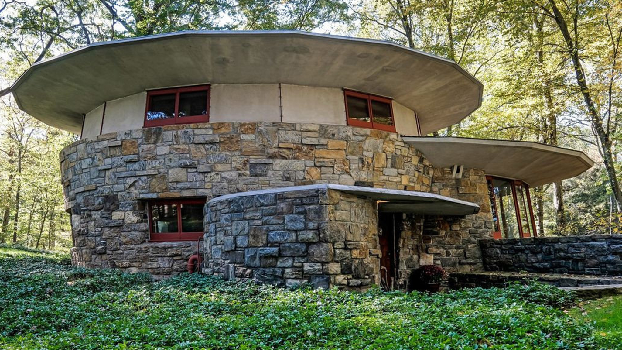

Closer to McCord in design is the Sol Friedman house, also of 1948. There's no doubt about warmth here, with stucco and stone in earth colors. The conical tent, with an umbrella-spoke ceiling, is absent here, as well---an improvement, in my view.
