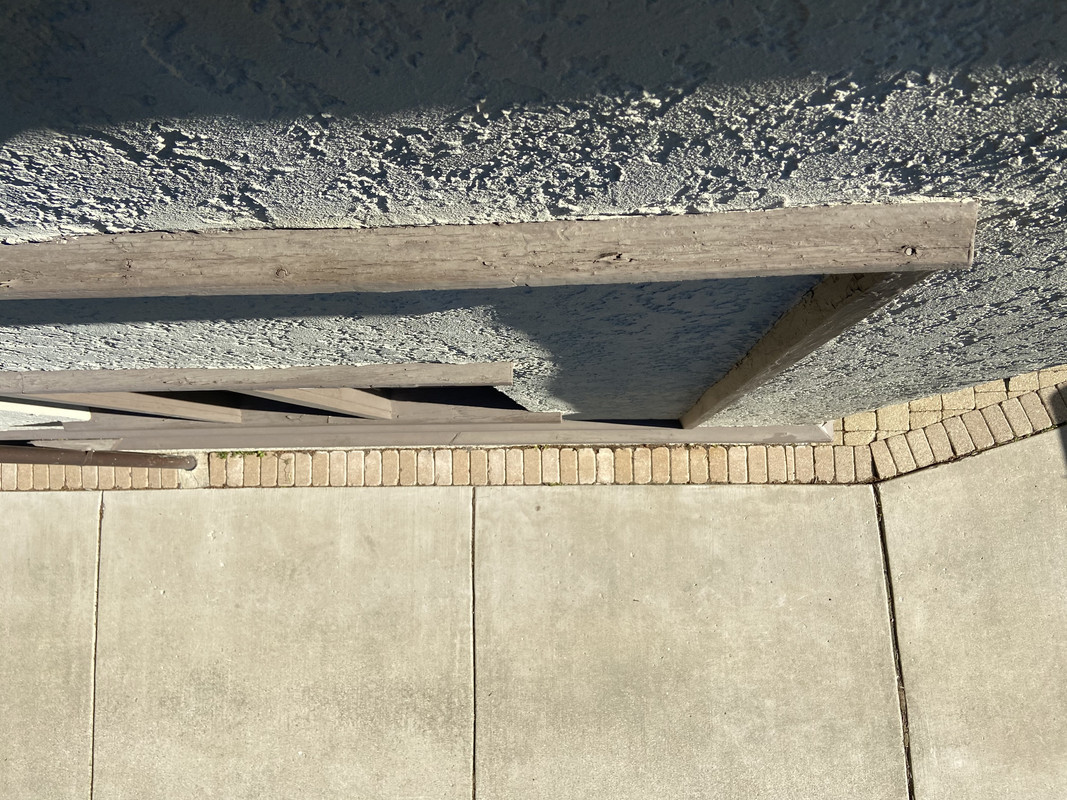

Wonderful! So glad to see the evolution and the fix - though it is interesting that it was applied in a variety of ways (E. Howard Hyde House owners have shared an image with me showing wood, not tin, in this space. - Perhaps Mike will attach here.)
I wondered the same thing about rookie error. Who knows what version of the drawings Hermann Krause was working with? That, coupled with no site supervision and builder Krause not getting paid would make the flashing leave-out easy to understand.

That’s correct. The H Howard Hyde House has wood “flashing” filling the space above the headers and tops of the trim. I assume it’s original to 1917, but seeing the question of it here makes me wonder if PD Diamond, the builder, took it upon himself to add it, if it was included in the supplies from Richards, or if it was modified when the stucco was re-done on the house.
