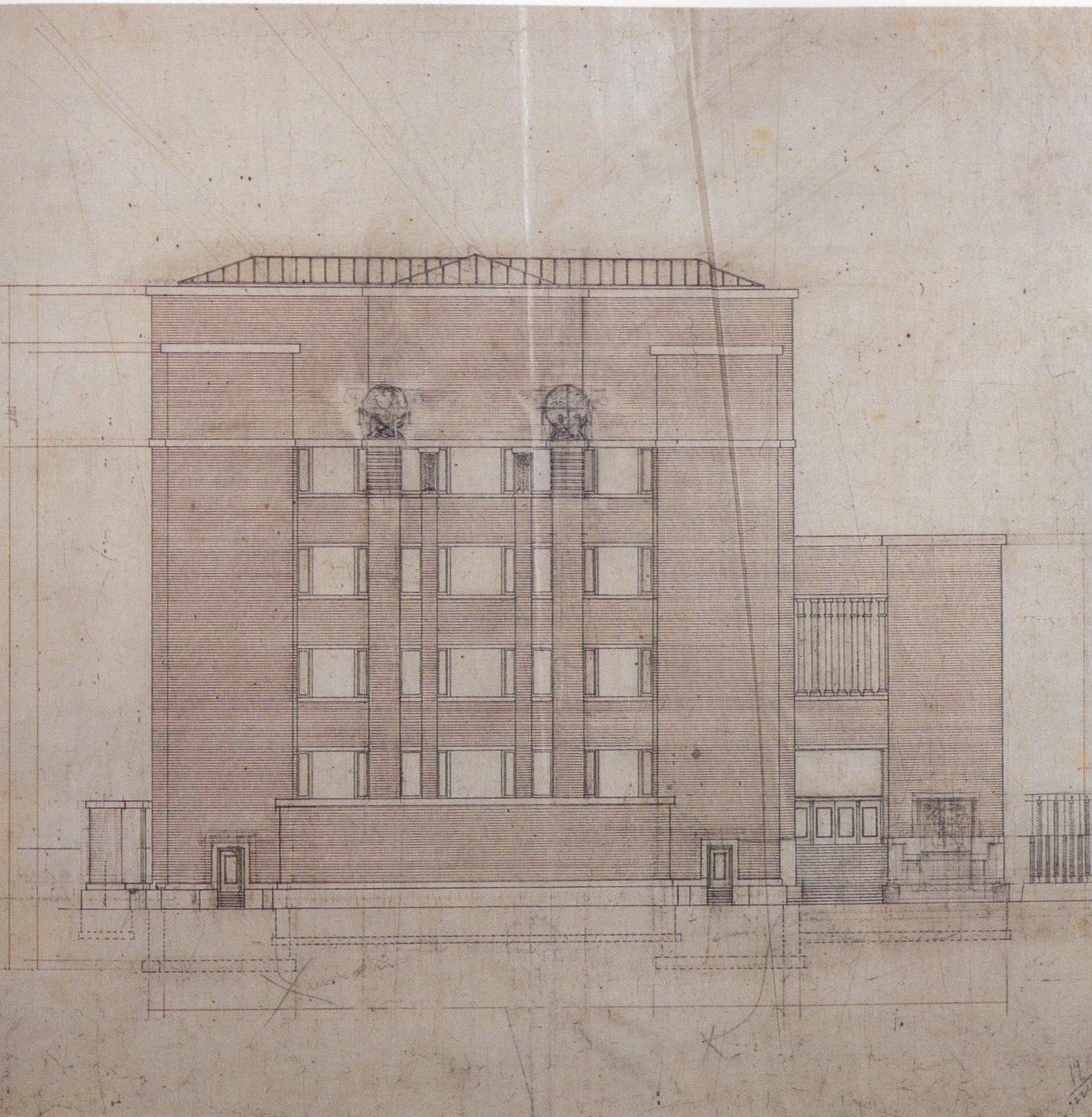

PAT: that's a good point!, photos from that pier are usually so poor that the color of the stone is not obvious.
SDR: About the scale of the fence, you are right! According to this drawing:
http://www.ad.ntust.edu.tw/grad/think/9 ... ges/18.jpg
"my" fence is about 50cm too short:
Thank you very much for all your comments, as a result the project will be more close to the original.
