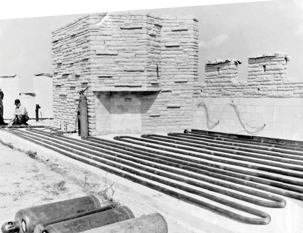

Our biggest change will need to be a replacement of the failed "gravity heating system" with a new hydronic system, but we will replace the concrete with original grids. I came here hoping to discover a method to retrofit existing hydronic pipes as we have the original layout, but to no avail.

regarding radiant heat - it the pipes were installed with radius ends (rather than elbows) there is a very good possibility that new flexible plastic piping can be pulled through the old wrought iron piping. that way the concrete floors can stay in place and, like electrical conduit, the plastic piping can be replaced in the future if it ever fails.

outside in, what is the identity of the photo you posted ? The diameter of the pipe is impressive . . .

I will check with the hydronic contractor but I believe it was determined not to be feasible. I'm not an architect and leave technical discussions to my husband, but I recall that there were reasons why we couldn't thread PEX tubing through existing pipes. The house had additions put on each end (car port enclosed in 1944 at one end and a bedroom addition added by Van Fossen in the late 40s at the other end) neither of these spaces were connected to hydronic system. Also, this area has high radon levels, the new floor allow for a protective barrier as well as insulation so there is minimal heat loss through the ground. I believe I recall the geo thermal guy saying w/o insulation there is approximately 30% heat loss through the ground. I also believe there was discussion about the existing plumbing not being used for so many years (vacant since 2006) would most likely have issues.
Believe me, this is a huge expense. I had hoped that there would be a remedy for keeping the existing concrete floor but we have been told that it is not feasible in our case. The floor will look the same when completed but will provide us warmth for our cold winters so that we can live in the hose year round.
