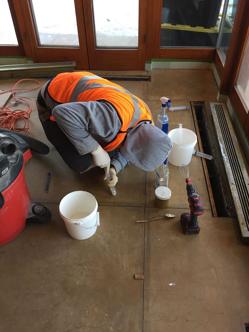

through the years, the yellow/gold floors were stained with brown in hopes of making it look like leather and then sealed with a clear acrylic coating. The coatings are being removed with a soy-based stripper.
the colored concrete floor was created by first pouring a structural floor slab of traditional concrete, which was then covered with a 1 inch thick decorative concrete with integral color. Unfortunately, the contractor must have waited for awhile between pours, and the topping slab has separated from the structural slab below. A lime-based bonding agent (not epoxy) is being injected into cracks to reattached the topping slab.

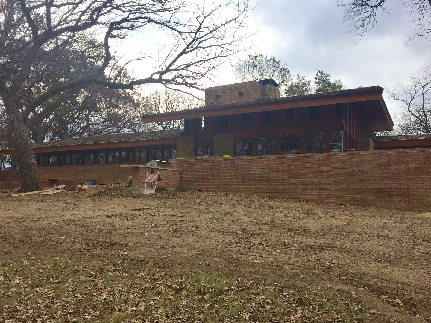

The back terrace wall has been rebuilt using stainless steel flashing beneath the rowlock top course and the rest of the wall. The flashing uses a dovetail pattern to properly bond the masonry together.
Bentonite is being used to pull dirt from the old bricks and remove calcium deposits.
A new patio/terrace is being constructed on the back of the house AT GRADE to provide the owner with outdoor space for the summer.
A reflecting pool, planters and tinted concrete placed on the grid are the hardscape components. Small gravels and soil will be placed between the concrete pavers to allow small plants to flourish. The rest of the property will be allowed to return to the midwestern climax forest of Oaks, Hawthorns and native plants.

Great photos -- thanks, outside in. In the photo with the caption about the flashing, is the brick being tuck-pointed ? The finished wall looks great . . .

Our house was originally built with a structural base slab and a 1” topping with the shake on tint. There is some cracking here and there, but one spot in the living room has a hollow sound when tapped....it is not loose.
Did you encounter hollow sounds at Fredrick?
Is the lime based injection a commercially available product?
Does the filler fill the crack such that it needs tinting?
Posts: 1100
PostPosted: Fri Dec 15, 2017 2:49 pm    Post subject: Reply with quote
the concrete contractor drags a hammer over the floor, and its easy to hear where the slab has separated. We're not bothering to fix small separations. I'll have to check with him to see what the specifics of the lime mix are as well. Small holes are drilled (1/8") along the cracks - the material fills in the void and works up through the crack. The cracks are filled with the material, and when dried are tinted to match the adjacent concrete. We are planning a tinted lime wash of sorts to even out the concrete color before sealing. The current debate is whether to use a clear concrete sealer and wax, or just wax.

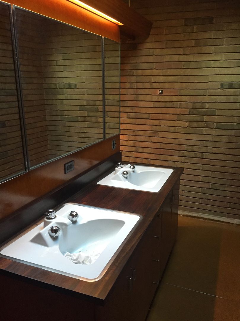

Furniture has been fabricated, finished and installed
Master Bedroom and Bath
I apologize for the little LED "dots" - the diffusers have not been installed yet
Guest Bedroom
Kids Bath original Henry Dreyfuss-designed sinks with rosewood top restored

Hoo-hah. Look at that. All the lovely ribbon mahogany, for a start (or a finish). Looks like Chicago common brick, but longer than standard ?
Does the client have some Heritage Henredon pieces, complemented by the new work ? Was the molding available, or did it have to be created ?
