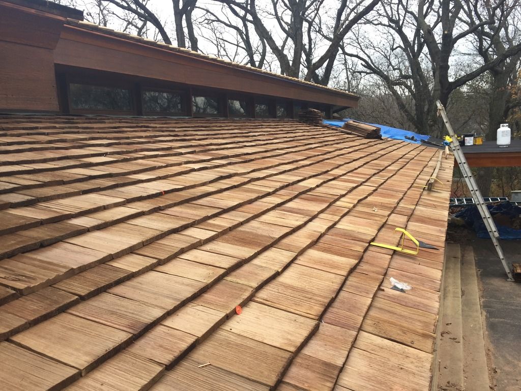

The brick used on the house matches that used by Saarinen at Cranbrook - it appears that Fredrick chose the color and Norman brick size. Cleaning was accomplished by steam, no chemicals:
Similarly, Fredrick requested Cedar Shakes rather than Shingles. The roof work entailed filling the 2x10 cavity with cellulose insulation, and then placing a 2-1/2 inch rigid board panel over the sheathing, resulting in R=45. Wright specified that the shakes have varying exposure.

PostPosted: Mon Dec 19, 2016 11:52 am    Post subject: Reply with quote
So, I presume the ones removed weren't the originals, given the uniform exposure?

Posts: 1157
PostPosted: Mon Dec 19, 2016 12:03 pm    Post subject: Reply with quote
the shakes that were removed dated from 15 years ago - this is the third roof
Posts: 8789
PostPosted: Mon Dec 19, 2016 1:08 pm    Post subject: Reply with quote
Shakes work on this house. They were less successful on Chauncey Williams.
