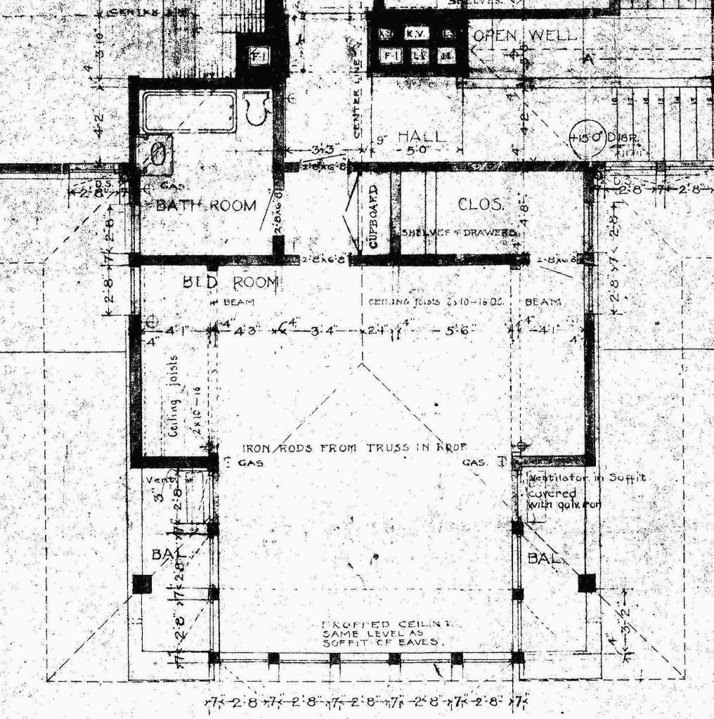

I'm sorry, I thought I had already posted this, but the two balconies on the second floor of the Willits House are formed by the location of what were to be two iron rods suspended from a roof truss above, similar to the Bradley House. Wright was trying to improve upon the proportions of the front bedroom by moving the rods to the outside and provide support for two girders that were to run in the ceiling of the living room below. Hence the need for the balconies. Unfortunately something must have happened during construction and two I-beams were installed (with construction nearly complete) to replace the hanging girders.
Posts: 1058
PostPosted: Fri Jan 04, 2013 3:17 pm    Post subject: Reply with quote
and to my knowledge, Tom Heinz never really worked on the house, he posted a series of articles written about the house that were full of errors, such as his assertion that Willits was to have radiant heat, etc. I should also add that Storrer's assertion that Wright designed this house on a module is fabrication as well. In looking at the dimensions shown on the drawing above - have you ever heard of designing a house on a 3'-3" inch module?
The module that Wright was working with was the size of the window openings, 2'-8", and the structure fell between. This is what Charles White was referring to, not the planning module based on Japanese matts blah blah.
