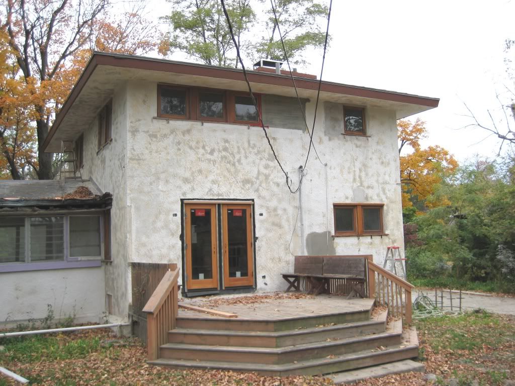

Progress - the purple is almost gone - fascia board stained, roof installation complete, chimney done (with final original stucco color) and brown coat of stucco complete. I've decided to soda blast the exterior (after the dry sandblast) to make sure ALL of the adhesive-laden contemporary stucco is removed to allow a final float coat of tinted lime exterior plaster per the original. Next week plaster begins on the interior!

PostPosted: Thu Oct 21, 2010 9:30 pm    Post subject: Reply with quote
Looking really good!
What, if anything, are you planning on doing to protect the house, and your restoration/rehabilitation work, from the "improvement" and "expansion" ideas of future owners, especially after all of this work has been done?

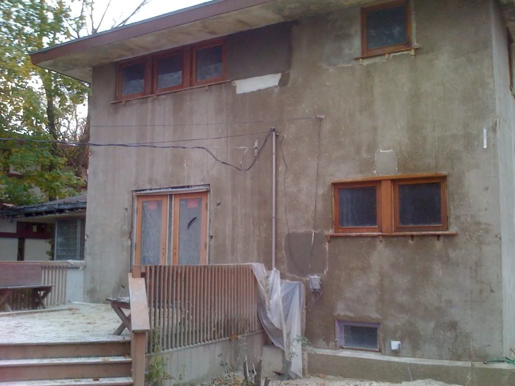

Finally, the hot water/silica sand blasting system removes ALL of the adhesive-laden stucco overcoat and exposes the original brown (gray) coat, making a perfect surface for a traditional tinted lime plaster finish. Note to self: use water-based, not dry sandblasting on future projects. Upstairs floor sanding starts today!

Thanks for the pics outside in, the house is looking better with each installment.
What has been your strategy for windows and doors? Restore the originals, custom replication of the originals, replicate, but with insulating glass, or a little of each? I ask because the windows and doors look correct to the period but as if new.
Posts: 1226
PostPosted: Mon Oct 25, 2010 12:40 pm    Post subject: Reply with quote
The doors and windows are original, except for the patio doors which were added to allow access to the rear yard. The glass in the windows was designed to be held in place with wooden stops, but the contractor switched to glazing putty, which meant that the windows needed to be painted, not stained. We removed all the subsequent layers of paint, reinstalled the glass with wooden stops, per the drawings, and stained the sash using Sikkens. Each window opening will be fitted with a roller insect screen, and an insulated storm window installed at the location of the former screen window for an R value of 7. This method allows all of the windows to be open during the summer with screens.
