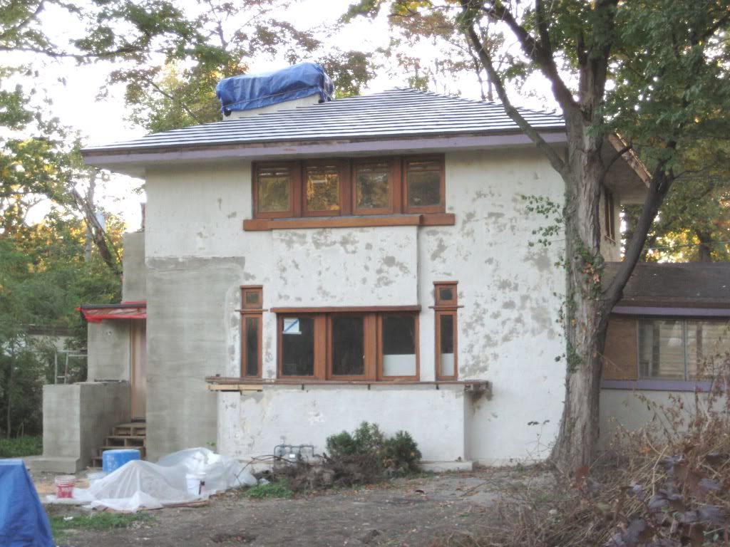

PostPosted: Fri Oct 08, 2010 1:40 pm    Post subject: New Photos Reply with quote
Here are some progress of photos of the work on the Ross House
Posts: 6681
PostPosted: Fri Oct 08, 2010 1:52 pm    Post subject: Reply with quote
My gosh!!! What a fantastic difference from when the 'Purple House Eater' was still attached!
Things are looking great. I especially like the restored covered entry w/ the beveled wood facia.
Posts: 5964
PostPosted: Fri Oct 08, 2010 8:16 pm    Post subject: Reply with quote
Amazing transformation!
Posts: 16909
PostPosted: Fri Oct 08, 2010 11:16 pm    Post subject: Reply with quote
Is this the new roof, too ? I like it. Wonderful progress.

PostPosted: Sat Oct 09, 2010 5:37 am    Post subject: Reply with quote
Very cool. Is it going to get another coat of stucco over the entire house?

Posts: 6681
PostPosted: Sat Oct 09, 2010 7:12 am    Post subject: Reply with quote
outside in wrote:
4 inches of rigid insulation have been added to the roof. With additional attic insulation the roof should be R50.
Posts: 1163
PostPosted: Sat Oct 09, 2010 11:03 pm    Post subject: Reply with quote
Yes, this is the new recycled aluminum roofing panels, and I'm very pleased with them - 30 year life expectancy and then it gets recycled again. The stucco is a problem - its been sandblasted, but it was difficult to remove ALL of the contemporary (1960?) stucco because of the high adhesive content in the mix. The original appears to be two coats (scratch, brown) with a topping of lime wash, comprised of lime, sand and tint (no portland) which was covered by an acrylic bonding agent and a topcoat of adhesive- laden stucco. I am contemplating blasting it again with baking soda and water in order to remove all of the topcoat and trying the lime wash again, but the contractor is recommending ANOTHER acrylic base with a conventional tinted stucco finish. So now I'm thinking that I should delay this part of the project until this gets resolved..........
