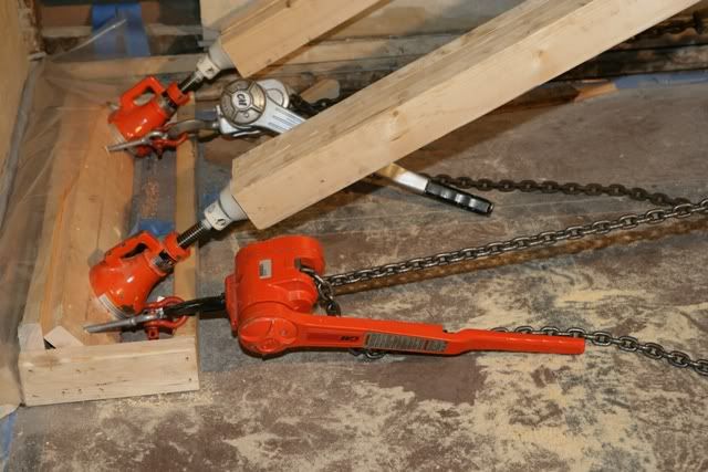

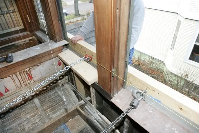

We repaired it this way. First we installed Horizontal and vertical string lines to measure the problem and to act as a reference point as we applied force to the structure. Simultaneously we did the following:
1. Jacked up the north facade cantilevered low roof.
2. Pushed out with 5 ton jacks on a diagonal to the top of the window.
3. Pulled in with 1 1/2 ton lever hoists, aka come alongs, in a horizontal orientation.
We did the work incrementally and we measured the change against our horizontal and vertical string lines. We over compensated slightly because from our experience we knew that the modest deformation of the wood structure would return. Once we had the structure in place we proceeded to make the structural repairs. The cantilevered low roof structure was repaired first then we lowered the jacks there only to check our compensation assumptions. We then adjusted our work to get the cantilevered roof in the desired position. We then made the repairs to the balloon frame studs and their connections to the windows. The structural engineer wanted to put long steel plates horizontally above and below the window and vertical steel plates in the wall from the foundation up the wall and through the window mullions. This posed enormous challenges to build which I was not willing to accept for budget reasons.
We worked with him to come up with Plan B. Plan B was much more buildable and was "likely" to work, but it was not a guaranteed fix. Plan B involved: reinforcing the wall horizontally and vertically with additional wood members; installing shop fabricated steel brackets at the wood connections to the windows; creating a wood diaphragm with the new 2x6 ceiling joists and plywood. This was designed to hold the wall above the windows, at approximately its unsupported mid-point in place. We made the repairs and partially released the jacks and the lever hoists to check the results against our string lines. We tightened everything up and made further adjustments to get the proper alignment. We repeated this a second time. When we took down the jacks and hoists, we continued to monitor the wall. After approximately a week a small increment of deformation had returned. However this is only noticeable if one knows what to look for and carefully studies the wall. We were thrilled with results to a perplexing and challenging compound bulge. This structural repair took approximately 5 weeks for a highly skilled carpenter aided by two architect carpenter assistants.
These photographs were taken right before we took down the jacks, lever hoists, and temporary framing.
