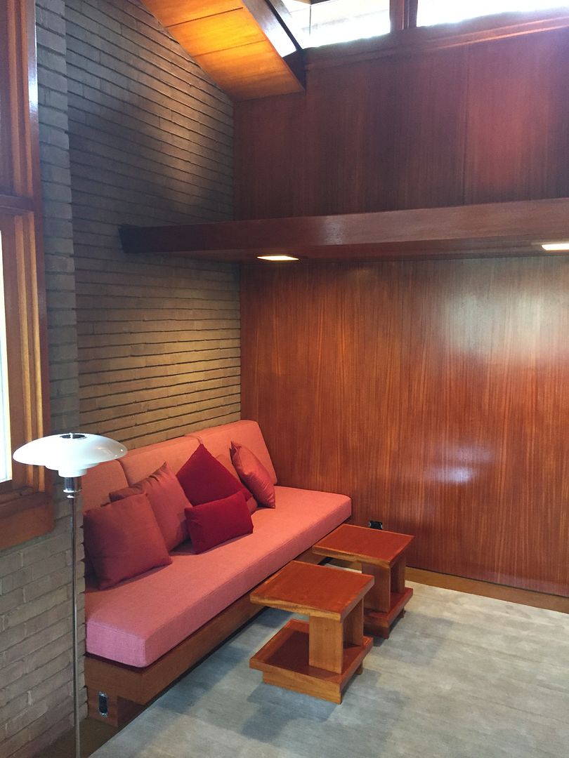

PostPosted: Thu May 10, 2018 9:38 am    Post subject: furniture and carpet installation underway! Reply with quote
Posts: 5847
PostPosted: Thu May 10, 2018 10:36 am    Post subject: Reply with quote
Love it!
That rose color on the bench is lovely. Nakashima, Wright and some fine natural fiber carpets. All looks perfect to me...
Yellowish floors... original color?

Posts: 3584
The Nakashima Conoid dining chairs and cushion lounge chair look great in just about any Usonian.
Posts: 1145
PostPosted: Thu May 10, 2018 10:54 am    Post subject: Reply with quote
The cabinet adjacent to the front door is by Nakashima as well. Louis Fredrick wanted to hire him for additional pieces but evidently ran out of money after dealing with FLW........
The floor has been restored with stains and waxes provided by Milk Paint
