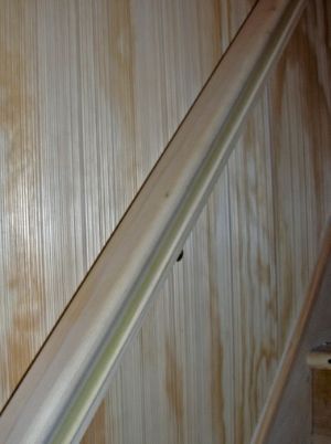

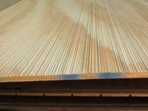

Here's some examples of our reproduction. The first one is simply an edge view, and the second one is from one of our customers who was not yet finished with the installation and painting.
