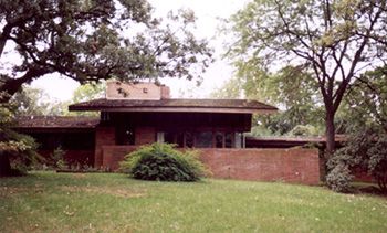

Louis Fredrick home, Barrington Hills, IL
Posts: 10575
Another house that eschewed the red floor is Fawcett. Mrs. Fawcett said she didn't want red floors because the brown dust that blows all over the area would inevitably be tracked into the house, and a brown floor would be easier to keep at least appearing to be clean. The wood also seems somewhat lighter than usual. For the lightest wood, see the Walton House in "California Romanza," pp 98-103, and FLW MCM, 306-309.

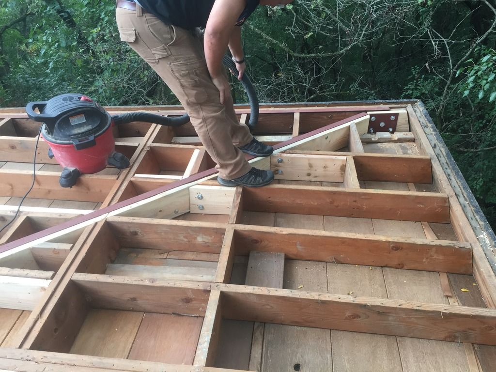

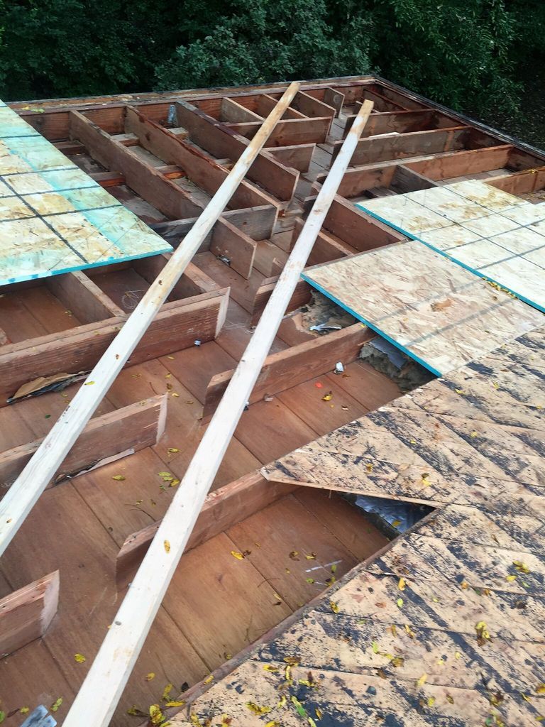

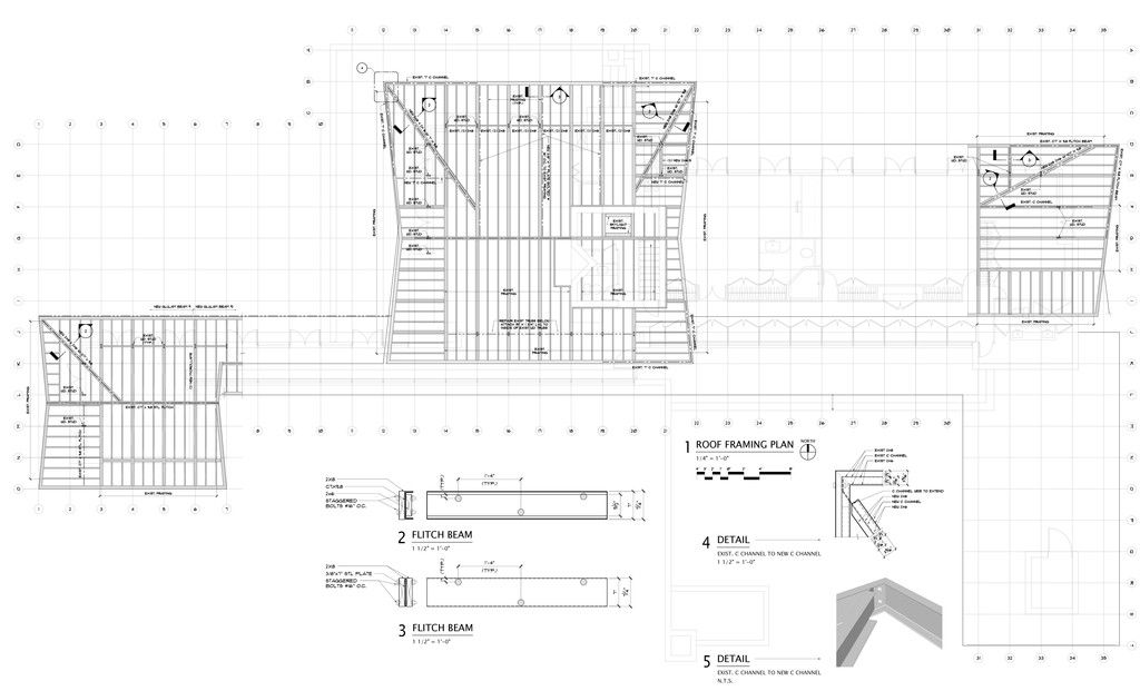

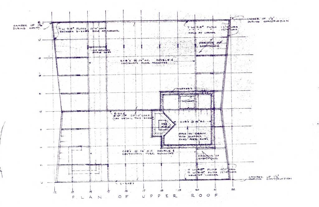

Looking at the original framing plan, the person responsible for the framing used "c" channels at the corners, but the channels only had 4 feet of backspan for an 8 ft. cantilever - but were very specific about running the sheathing diagonally from the corner to create a tight skin for support.
Why FLW avoided diagonals in framing is beyond me, but we decided to fix it as follows:
Cut through the existing framing to install steel:
New flitch beam:
Posts: 995
Post by JChoate »
Very interesting & brilliant solution. Thank you for sharing this.
