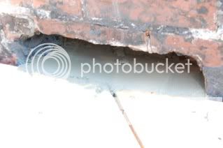

As you can see in the picture of a scupper through the parapet there is almost no room for water to drain out. The roof being dead flat with so many applied roofs that water did not pitch to the scuppers. In essence we had a pool over head.

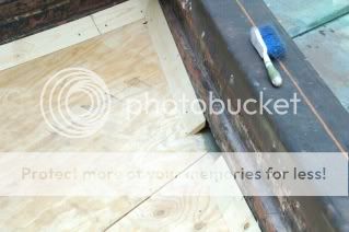

We knew after the tear off and all the rotted decking was replaced we would need to re-pitch the roof to the scuppers.
Sleepers 16 inches on center were screwed down to existing deck. 3/4 inch plywood become our new and properly pitched roof deck.
Cant strips went in.

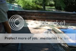

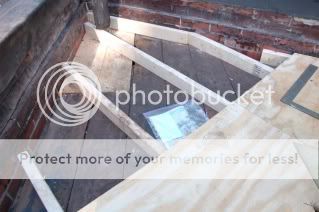

the first pic of this group of six, depicts sleepers and new decking pitching to 2 scuppers.

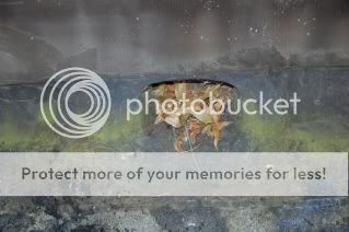

the second pic, state of the scuppers before tear off. as the roof had more roofs applied over the years the opening became small,very small. Plus the bottom of the scupper was a couple of inches higher than the deck. The result as you can imagine was a pool of water rather than a roof that drain properly.

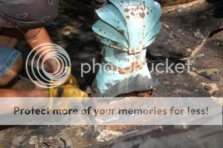

The third pic... we were living with one rusted cook top hood vent. Painted steel has only a limited life. For years we thought it was time to replace the "Clipper" for it performed very poorly but as we discovered the insect screen and roof vent was clogged with rust and debris.

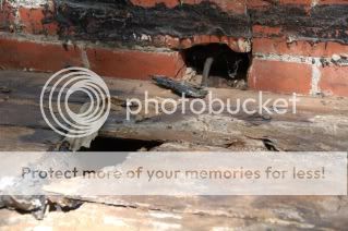

The next two pics show replacement of rotted decking and the condition of the decking after tear off.
The last pic illustrates the new, properly pitched, decking with cant strips in place.

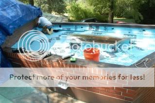

We used Sarnafil for two sections of our roof. Both sections are flat roofed and have parapet walls with scuppers. One over the utility room and the other over the workspace. Sarnafil is a Poly Vinyl Chloride (PVC). We first applied it over the utility room 6 years ago and it is performing beautifully as expected.

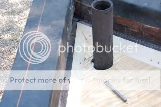

7. The newly decked roof with scupper ready to receive the Sarnafil.

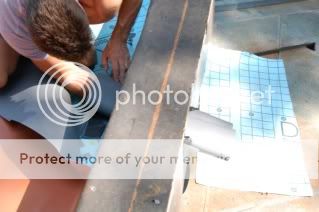

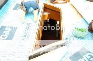

8. A breathable deck under layment manufactured by GAF, this replaced the common 15 or 30lb, felt paper.
9. As you can see we ran it up the interior parapet walls, curbs of the skylight
and through the openings of the scuppers.

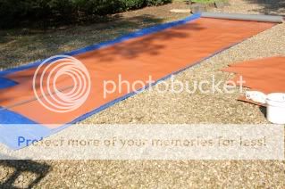

11. Laying out the Sarnafil.
Since we first applied this material over the Utility room years previous I had forgotten how many sq. feet I had on the roll.
I feared we did not have enough for this workspace project, which would have delayed the completion of this roof in a timely fashion. We were already a little tired of living with the blue tarp each evening. It gave the workspace a very cool, Blue glow.

12. New deck with valley pitched to the two scuppers. Ready for roofing materials.
!3. Note the 3 levels of protection...the Sarnafil, Iceguard & decking under layment. Not to mention the copper that will be installed.
14. Adjusting the Sarnafil through the parapet.

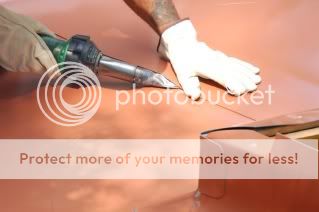

15. Heat welding the scupper.
16. Heat welding a joint with 3 inch overlaps.

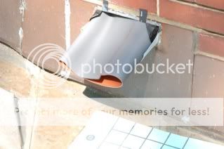

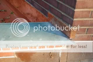

18. Finished scupper.
Note how the Sarnafil is terminated with an additional copper sleeve.
