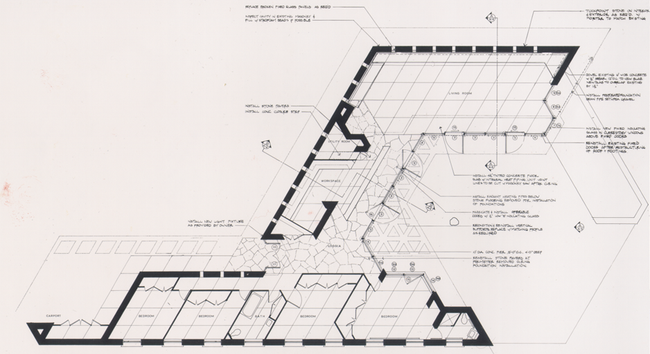

c'mon people -it's just math!
cos 30 deg. = .8666 x 4'-0" (module) = 3.464 ft. = 41.6 inches
minus 1/2 wall thickness (masonry @ 12") = 6 inches
minus 1/2 wall thickness (wood @ 2-1/4") = 1-1/8 inches
Total Hallway width = 34.4 inches

Posts: 10532
The math is correct, except that the unit lines, which are centered on wood walls, are flush with the interior of the masonry walls. So the net width would be 40.4", if the published floor plans are accurate. That was FLW's usual method, though not always: Suntop used center wall dimensions throughout, while Jacobs I, for instance, did not.

Posts: 1271
The Masonry Wall at the Smith House is centered on the unit line....
Needless to say, the width of the hallway is pretty much standard - and its the 2x4 framing at the roof, and structural support system that leads me to believe that Wright was intimately involved with the design.

It's unfortunate that some the original furnishings were picked off by the mob squad.......were any of the furnishings rebuilt during the restoration?
Thanks for posting the additional drawing......it's interesting that the restoration was confined the living room. Was this due to cost or because the bedroom wing wasn't in need of renovation?

Posts: 1271
Good spotting! - high clerestory windows in the kitchen but sorry, no perfs. I forgot about another nuance, the limestone pavers run through the entry and out onto the courtyard - scored concrete in living,dining room, kitchen, bedrooms, utility and bathrooms.
