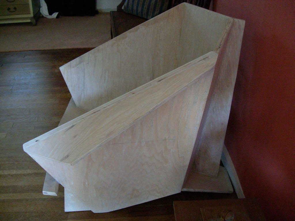

My Chair So Far!
Hi,
I have completed the huge task of stripping the terrible paint job. It was a massive undertaking. The paint did not go easily. I am sharing photos of my chair because the back and the seat are so different from the other photos. Does anyone have additional thoughts before I continue to the finish and upholstery?
Thanks,
[/img]
Thanks,
[/img]
