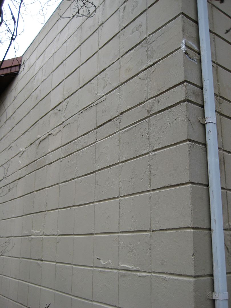

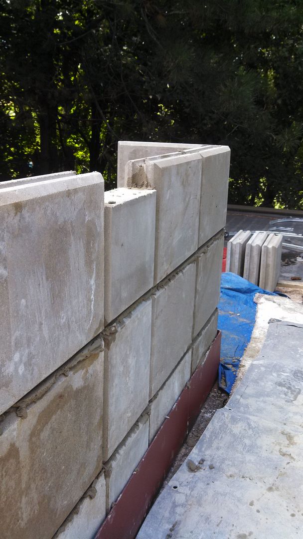

at the Winn House, the blocks were each 3 inches thick with an air space between. In some cases (such as in the raised roof over the bathrooms) the walls consisted of a single wythe of block. We had to rebuild the walls because of poor flashing details and deterioration. The blocks were made by a local block manufacturer and were easily done.

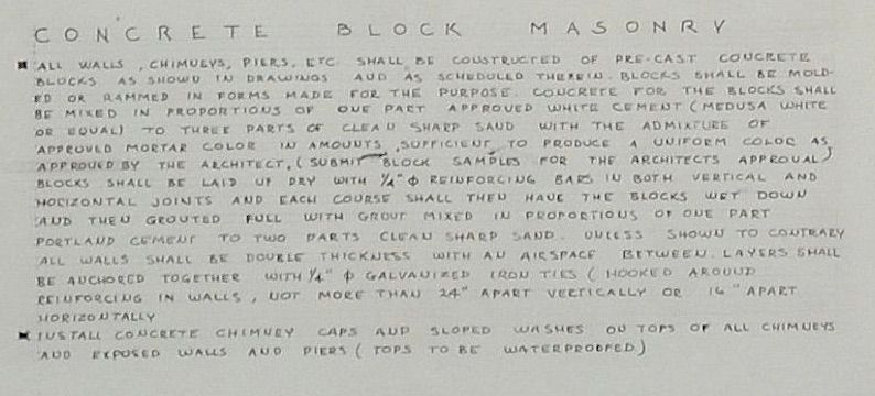

The trouble with the system is that there is very little mortar covering the steel. We used epoxy-coated rebar which wasn't available in the '50's. The shape of the block also invites water into the joint. I have attached a photo of the wall of the house, where you can make out deterioration of the block at the joints, caused by oxidizing rebar (can expand to 10 times its original size) pushing the top of the block outward. I believe all of the homes in this area suffer from this problem, and will, of course, be very difficult to repair in the future.
Below is the note regarding the blocks on the original drawings:

Many thanks for the photos John.
In the photos, there appears to be compressed wet mortar between the blocks. The Masonry Note you provide indicates dry setting with grout poured in at each course. Is this mortar that was applied to seal the joints? or ooze from the poured grout?

thank goodness they were not laid up dry - the steel would be completely rusted by now.
We found that all of the joints were "buttered" on the opposing surfaces.

Fascinating. Thanks for once again correcting my errors and setting the record straight. The specification certainly is---what---a bit naive ? Perhaps the assumption was that the "grouting full" of the joints---after (or during ?) each course of block---would inevitably produce the kind of squeeze-out of excess that we see in your photo, and thus fill (with some necessary if unmentioned tooling) the joint ?
Judging by the rebar visible in your photo, plain 1/4" rod was found inadequate as well ? What technique might be used to center the steel in the cavity---assuming that was thought to be necessary ?
